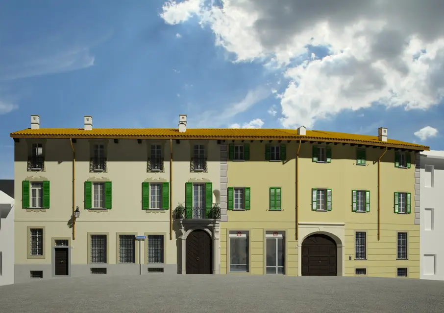

rendering villa luino
  • Thread starter Thread starter gabberman
I think it meant a bump without tile, applied to the whole wall, that the face appear not perfectly flat as you can see but with those defects of flatness typical in renovations.
in that case the sun creates a light chiaroscuro on the wall that clearly increases when the angle of light incidence decreases.
ah, ok, then it can be, I didn't understand.... but so much "there will be a reason" also for this:biggrin: :tongue:
In fact it is too smooth,so it could be pretty.maybe to put darker materials or create a thicker effect to decorations on the prospectus in the corners and on the windows. a little street furniture, the asphalt in two materials, magari with the wet effect so as to give the impression of heat.
However they are only small details for rendering, then for modeling nothing to say, before, it seems accurate in the elements placed by the photos!
I agree with your assessments (on all fronts, work and render :) if I can break a spear in favor of gabby (:) according to your criticism. I don't like nenache to me, they are flat, too sharp, a little bit insulted if we want, but the noise according to me goes to tastes, the trend today is to use it, but to me it never liked (according to me it was maxwell to bring the trend of noise, a engine biased like that until some time ago could not do otherwise and since anyway wanted it was always the most "physically correct" it is also used. other thing, the bump that is missing, if you mean that on the walls, can be due to the low resolution, but comunqeu when you photograph a wall from afar, of those of the classic houses, do not tell me that you see the "sbrognucolatures" of the wall... So you can stay.
for the engine, I do not make text, use vray ever and I am in love for quality and speed... mr according to me is too "metallic" in the rendering...
for my personal criticism, instead, lack of "heavy", yes, they have to go Sun a shipyard billboard, but I always preferred the quality even in these cases, so much for a stuff like this an hour or less of rendering does not change the life and sects you put the same time to make them (even because if you made a novo render for the color of the wall that you could well act in ps in.... 5minuti we say, you can also make it calculate an extra orc for better settings); the shadows are too clean, it is true that that of the sun is not a light area, therefore certainly net, but if you observe the shadows of the real sun, however they always have a slight blur on the edges and with vray is very silky is what.
another note, the antialiasing filter, you immediately notice that it is too hard, I would use a sharper one, like blackman, gabby you will have definitely used a mitchel or a catmull.... you can see the edges too pronounced of the objects that make them "finti".
then, as they have already said, the rains are to be reviewed completely.
I know you'll have an excuse for every point mentioned. ...
noise is a fault of maxwell renderings stopped too early, certainly not put it, would not make sense:tongue:
x rendering parameters are high, I don't think they're low...
the bump on the walls there is, at 30% in the rendering that I posted you notice - x that the image was compressed, even there is the displace in the hoof and on the asphalt.:mixed:
the rains that do not go??? I'm like a project.
about the urban furniture I put everything in reality, I couldn't matter other things and I didn't have the plants of the square.
the only thing that bothers me is that young people, for example, do themselves in 4 to search for clients (maybe they also subpagate) and spend a lot of money for performing machines, while the usual obverses are incorrect.
However I express my opinion on the renderings stating that I do not like, they seem without pattern or noise, there is no bump, at first sight...rending everything very artificial.it is useless to say to those who use maxwell...eh? I think it will be the next plug that I will study after mental, although I recommend v ray
go that as well I do in 4 x look for the clients, as well as I often do not get paid the right, as well I spend money x pc etc.:rolleyes:
regarding noise is a defect of maxwell, the bump there is and also the displace, I have already answered above.

speaking from "photograph" I would say that asphalt does not have depth, it seems painted on the wall.
But the air is not transparent and at that distance one should perceive a certain opacity.
I don't know how you could do it but if you look at a photo what makes it "true" are the flaws of the photo (grain) and a certain "fog" in the outside.

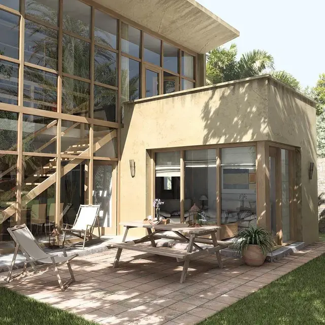

In the two attached images of a gentleman who considers a guru in the technique of photorealistic rendering, you will notice how shadows, small defects and the "transparency" of the air revealed by light, give a sense of depth and reality to the images.
You will also notice that the resolution of images is only 800x800 and 800x518, yet.... .
the day I had to devote myself to rendering professionally, I would study these two images thoroughly.

I wonder, however, if there is no photoshop:finger:!it is remarkable, especially if of that size. I would be curious also on the engine to render.

really beautiful:finger:, but there ps did his, I assure you! :biggrin:
p.s.: who is this? I would like to see your site if you have one:wink:
you fall easily, they look very true.perhaps in the first is the seedling in the pot that seems strange, or maybe I see badly..cmq I am curious too and I add to the requests of information on the venerable figuro

here is my last job: 3dstudiomax + vray (the color of the plaster was wrong and I had to remake the rendering)
the light is, imho, horrid. I don't know anything about rendering, but I look forward to them. this is more "plasticous" than a photograph made with a compatine, saturation of ball colors and contrast mask in handcuffs.
right by curiosity, you for photographer passion? If you do, how can you set such rough lights in a virtual scene? If you don't... it would be time to start and then return to renderings. :wink:
It is true, the knowledge of photography can contribute a lot to producing better renderings:finger: ...and vice versa, there are now many interweaves between these two sectors.

I downloaded the pictures from a site that collects the works of a large series of Paraguayan architects.
http://arquitectos.com.py/portfolios&anno=2/The name is sebastian gaona.
really a big one, as far as I feel about rendering as landing on mars.. .
cmq even if it uses ps in post production. . What matters is the result. :smile:
Of course... :finger:, it was only to make it clear that for a good result you must necessarily know the techniques of postproduction :wink:.

I made the rendering, the shadows now are + soft, I set the sun size from 1 to 4
I have changed antialiasing, I have reviewed the rain material, I have increased the bump of the walls (if you do not see it is compression fault, in rendering you see well) I do not think to recover it as I have high to do, if you do not like patience.
