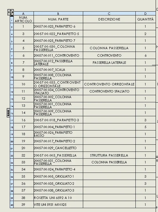

Hello to all boys,
Is there a system to reumerate the column - article n- in the separate material? I have removed / hidden details that do not center with must appear in separate.. only that the numbering remained that of before.
thanks to all in advance for any given answers.
not without changing them hand.
to do something clean and have sequential numbers you have, for me, two roads.
1 the most logical and correct is to exclude the elements from separate rather than hide them
2 reordering the distinct by putting into the bottom the elements that you will go to hide
thanks a thousand boulders, solved with the second option.
Thanks again and good evening you.
for the truth I had already solved by randomly trying the option number two confirmed and suggested by you.. Since I was working out so I didn't try anything else...
