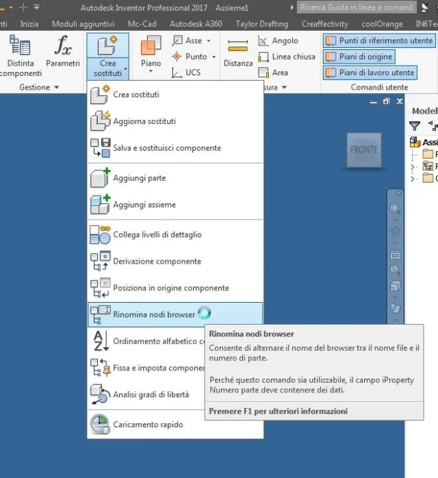

I'm replacing components in a solidworks set.
geometry is replaced, although not properly.
would be asking too much.
I take iproprieties correctly, but I don't change my name in the browser.
Why?
try using the "rename browser nodes" command that is in productivityrinomina.webp....usually works!
