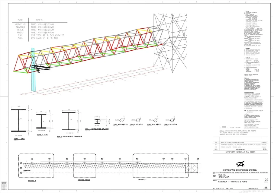

Hello, how can I achieve this reticular structure with revit?

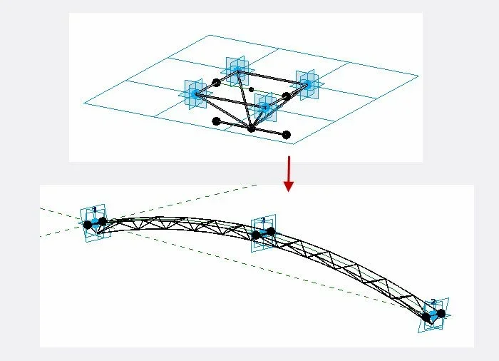

definitely, with adaptive components. here is a species:
it takes an entire chapter of a book x explain step by step all this... search on youtube and google
you make a "panel" with the model called "low generic model in pattern" and then it is loaded into a family that uses the model of "adactive generic model" and is used "divided and repeated" with the first family on a divided surface. about more information about these topics in wikihelp or other similar places.

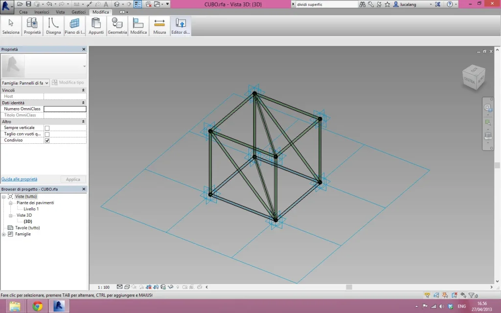

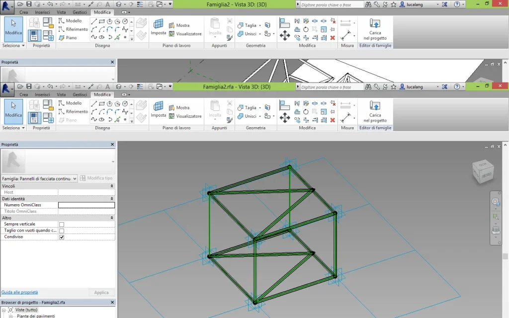

I created this family and now I should create through this family a suspended path/tunnel consisting of several blocks.

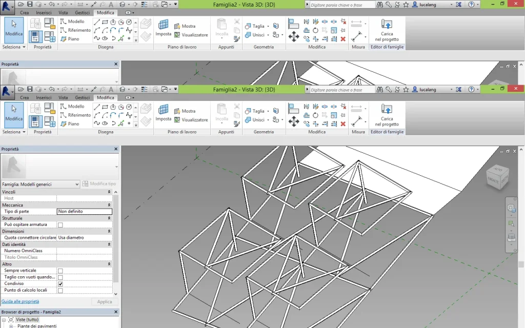

I created my structure disastro.webp ma quando la vado ad applicare succede questo bha.webp that is, the base fits while the rest keeps the size I gave when I created the family. How do I make everything adaptable? I'm going crazy. :36_1_25:
all objects that are shaped in the panel family should have "constraints" with reference points or reference lines. you can not simply model as in generic families.
and a little difficult to explain this in many messages of a forum. maybe, there are videos in wikihelp or youtube that can help you.
