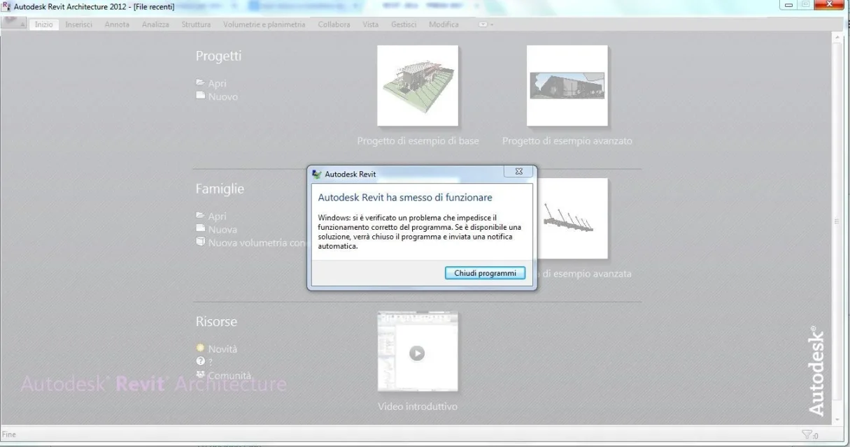

Hello everyone I need a mega pleasure.. I need urgently for the revit program for the university.. I tried to download the trial version from autodesk, after several attempts I managed to install it.. Now when I open it tells me "autodesk revit stopped working" I tried with the resolution of problems but nnt.. to uninstall and install again but nnt.. to make mistakes correction and nothing.. before I bang the pc out the window, will you give me a hand? !
thanks in advance ^_^

I answered you in the other post... Avoid opening or starting identical conversations on different posts
