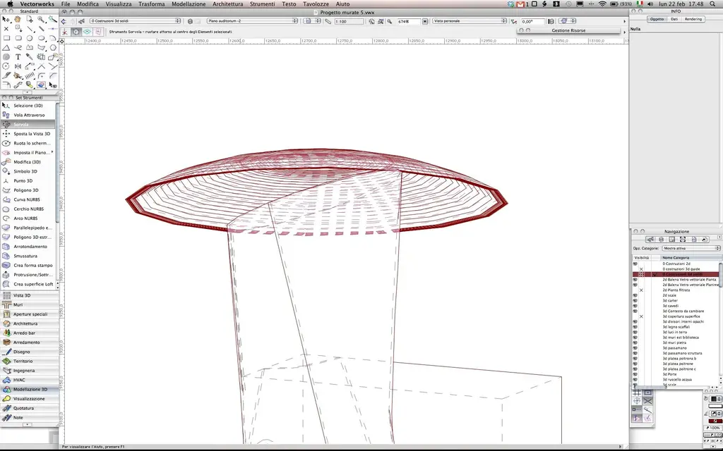

We're almost there.
with 2 oval nurbs and a locus comes to me like this.
more nurbs intervals more buy rotondity. :-)
