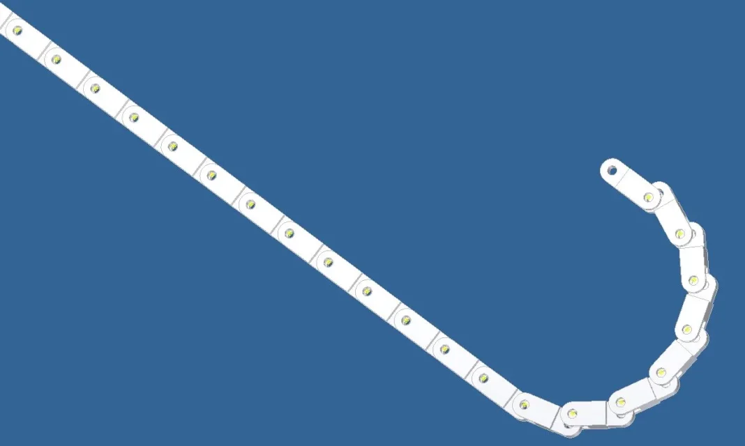

hello to all, I am new and I am not very practical of the job. I find myself building a roller chain in inventor and, since I have to simulate the path of some pieces running on it, I need to build the chain starting from an initial mesh and then make a series along my path... Unfortunately I don't know why the inventor doesn't make me do the jersey series... How can I do that???? I accept suggestions and advice :)
I also tried following the instructions of the old discussion. . .
but the shirts along the curved part are tangent, not perfectly aligned
you must bind the first mesh between its median plan and the first point in the series.
I did it!
It's like you said peppe, you have to bind practically the centerpiece of the shirt on the first point of the series
I miss this concept
to do so I had to create a plan in half between the 2 pins
at the end is not very precise, but more than acceptable (see image)

Thanks tarkus, I had already tried to find something but unfortunately I had found nothing... I was wrong. However I could not make the series because I had to select the modality "model view" and not that of together. . thanks tarkus
I press that I have not yet tried to build the chain but then can you move along with the parts of the machine or is it just a static construction? in the second case you could do simply a sweep, or if in the machine assembly you will do only 2 or 3 positions (open type closed and intermediate) you could solve with an ipt ipart where in the sweep I mentioned to vary could be the size of the guideline. in the various positions then you could replace the necessary variant.

in fact I created a sweep, but they asked me for the simulation and unfortunately I had to create the asses with the series of the jerseys. Moreover since on the chain is mounted a pinion they have asked me also an animation in which the pinion translates with the chain and at a certain point wheel... since I do not use inventor recently I do not know sincerely how to do but more or less I managed it even if it is not very precise... Can you help me? or a suggestion on how could I do it? ? ?
I don't know too hard for me, who asks you something like that I'm sure it's the commercial classic that doesn't understand anything mechanical but wants the special effect. . :-)
Perhaps to bind piece by piece clearly highlighting axes first on the shirts and then giving angular constraints between a maximum and a minimum...if it is a chain portacavi the shirts are few to try.
