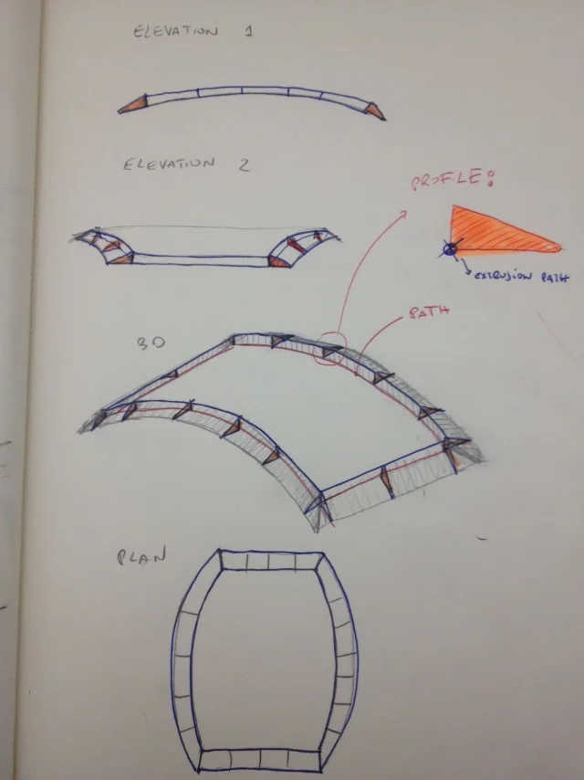

kubbah Guest Apr 24, 2013 #1 I would like to force this geoemtria that is based on an extrusion of a profile along a path. the path is curved both in plant and in prospectus. what is the best way to do it and what families to use? Thank you very much
Alfredo Medina Guest Apr 24, 2013 #2 in a generic adaptive model, use the reference splines for curves and reference lines for straight edges. in elevation, use reference plans by name to change the guest of points. then select the two curves, and "create shape".
