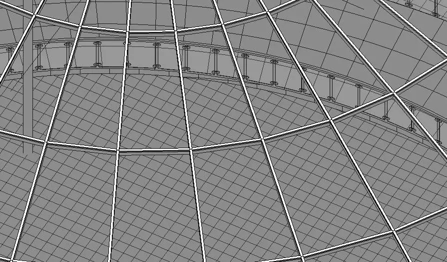

I can't tell if I managed to screw up revit or if it's "normal" all.
in practice I created a mass to then apply it the continuous facade (curtain system) and thus create a dome covering.

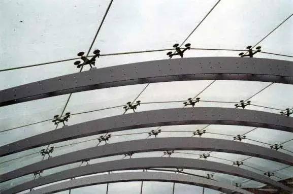

all right here, but then the need to change this standard stained glass system with a more modern one, like with the glass supported by the "ragno"... (both, I add photos).
fact is that in the options of the continuous facade there is nothing more than 1 montante... I ravaged like a brick, but I didn't come to the head... Where am I wrong? How can I fix this?
if you have maintained the same division of the surface, changing only the type of mount and applying an offset (for moving at altitude), should not disappear ....
I would agree with you, if not that (as you see from previous image) the list of the available mounts is a little scary.. .
charge the families of profiles
or
created the ad hoc profile, with a family of profiles (design in section) and load it in the project ....
