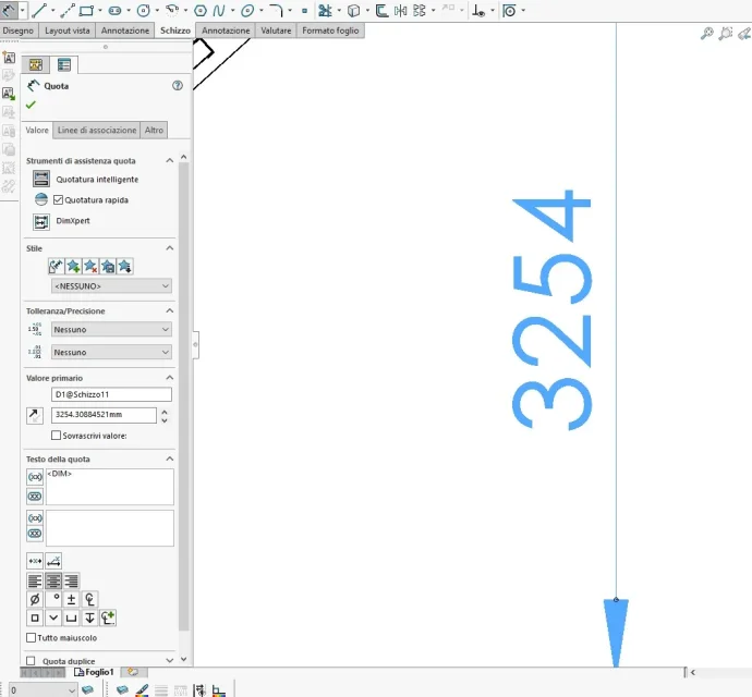

hi, sometimes I would need to round excess or defect the quota of a table,
I find how to reduce or increase decimals, how to overwrite the share by hand, but not how to round it for example to +/-5 or +/-10 -es. from 3254 to 3250, as instead I can do in cad 2d.
never succeeded?
possible?
How?

Sorry, I missed a ride, click on odds...
I did not understand how to do .. but in any case I fear that with "enlargement" I change all quotas, while I would like to apply rounding only to those I decide,

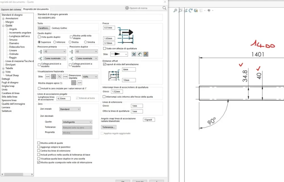

1401 round
34.8 and 40 instead do not round
say that it is possible or only by hand overwriting? :

property manager of the quota (on the left), open the curtain and choose rounding to 1,2,3 digits.
you can do for every single quota, if that's what you mean.
Hi, I think the only way is to set the document with rounding and round it all, and then change the type of rounding on those where you want to see the comma.
you have to operate backwards practically.

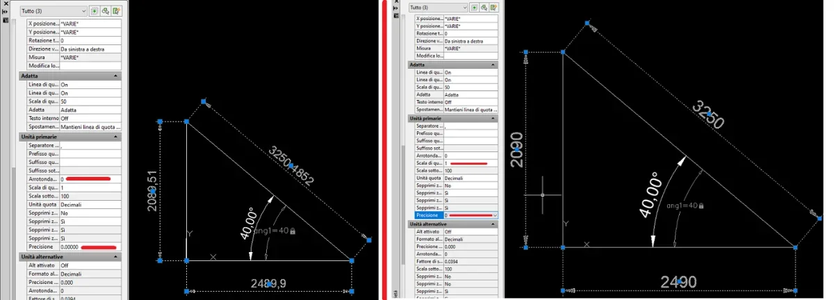

Gear and position of the parameters to set you will find them in the attached images.

however you can get the result of having all four whole digits without rounding and simply removing the decimals; to do this just change the 2490 cateto (see template to the right) as from image.
the image is of the design made in autocad, but as you see from the properties the only variation was made on the decimals and not on the rounding of the quotas and this you can do also in solidworks.
so I can answer your request.... here you go! ! !
