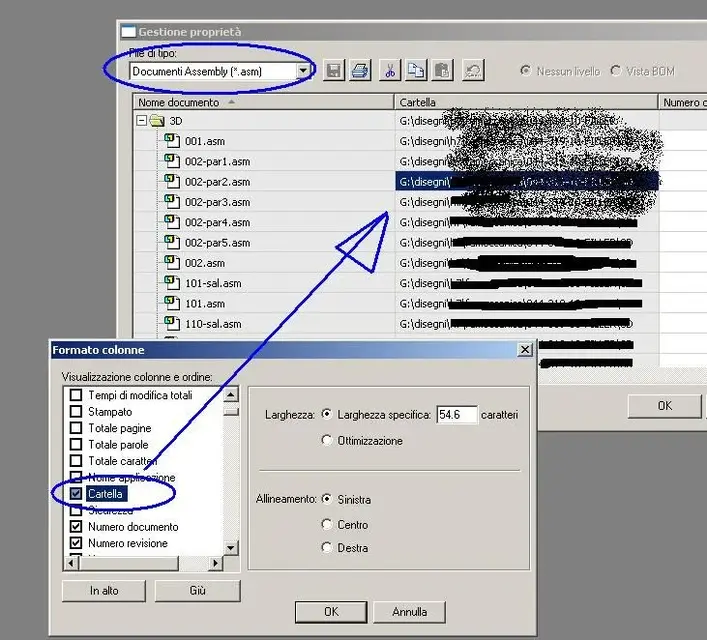

Um... but where are these asses? i.e. would you need to scan on multiple folders where there are assemblies and for each automatically would you make the list of folders where the individual parts are located?
I believe that the fastest method is to create an axieme containing all the axiemes to scan and then open it with the revision manager.
See if you like this:
open if without any open file --> ownership management --> open interest folder --> select columns --> view "folder"
Yes, and exactly what I need.
and a little hard when you have 200 assemblings...
