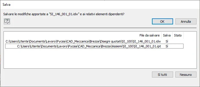

Hello there is something inventor I can't understand.
I change the part of a set and then open the relative table that is updated correctly, when unless the table puts me this popup appears:2019-08-07.webpand I don't understand what changes he asks me to save on the part... I currently put on the drawing and not on the part because it did not make any changes on the part.. .
Sometimes this popup creates several problems overwriting files that should not touch. . .
if someone can make me understand what happens :d
If he asks you to save it is because something has changed.
If you say "no", at the next opening you recycle.
could be the weight calculation that, every time, is to be updated.
