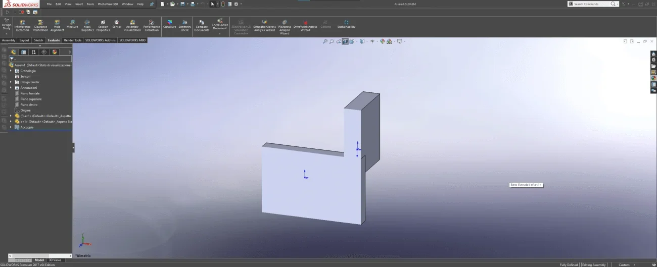

in an assembly I am doing a section but I know that everything seems "fuso", as if the bodies were not distinct.1611056595403.webpIs it possible to handle this?1611056632189.webp

Why not attach the file?
how do you understand how the half-image model is made?
here they are.
image with problem and starting p&g
  • Assem1.zip
    Assem1.zip
that do it in the preview is normal, but once the command is confirmed the edges are also displayed.
when you confirm the edges you see?
Thank you. to think that I checked that the check was present, not that it was to be removed
