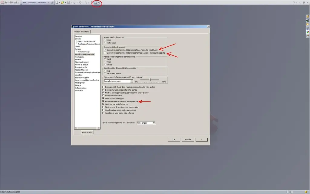

try to "play" with these variables system options:OPZIONI SISTEMA.webpHello
marco
