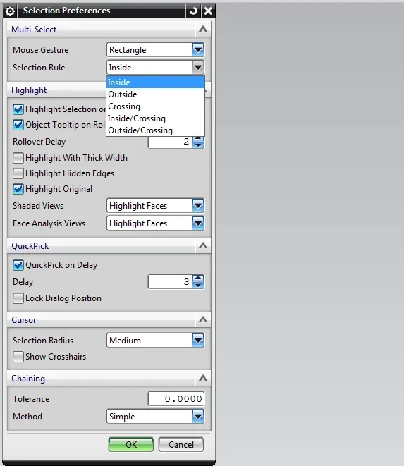

hi, maybe you have an activated selection filter (top left)
Unfortunately not, the filter you talk about is set to "no selection filter" and so I think that so includes all the filters below.
si alexfunk, are both set as you put them in the image.
baskets1959 even the settings that you inserted me are the same as I have.
is for what I asked for help, I tried to spray any kind of settings that seemed to me centered on with selection but without success unfortunately... .

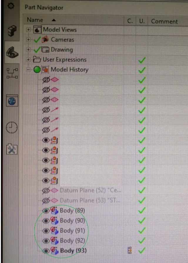

for my experience, I realized that the leotards cannot be selected with the selection rectangle, not even setting the filter on solid body.
a video is selected (red) but in the part navigator no.
