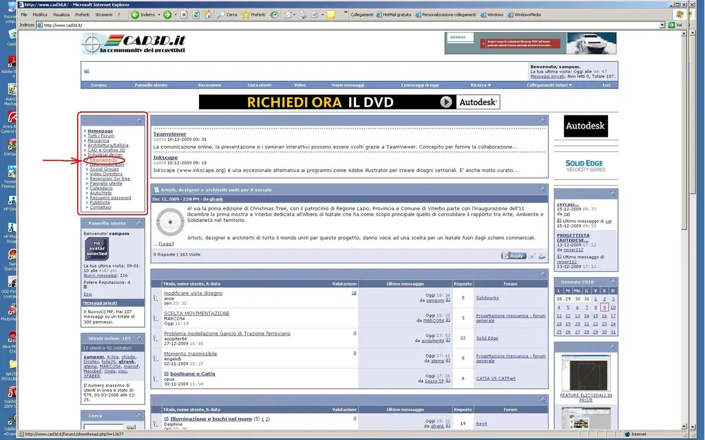

however you find them on the home page:REGOLAMENTO.webpgreetings
