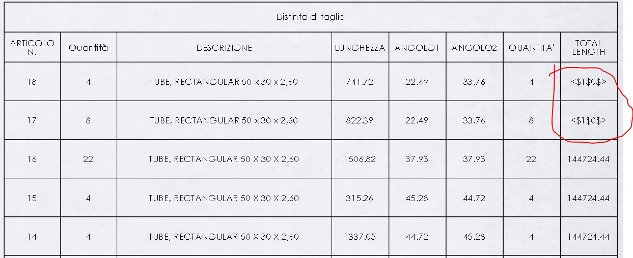

separate cut for welding.
It seems that the formula is wrong. even the values below do not seem correct.
I think he'll never be told enough times. for such specific problems you have to analyze the files.
However parts checking the sum is correct
Sure you have to check the file, however being a project that commissioned me I am not willing to make it public provided of specific conditions. you have already given me a starting point, which I had not thought for obviousness. Thank you.
I was referring to the sum, I understood that I had to make the sum of the lengths, with the calculator... .
Anyway, thank you all.
Consider that the total lenght column refers to the overall length of that profile type and not of the single position
It's an automatic value, so it's strange that it's the written one... perhaps you have inadvertently modified the variable
