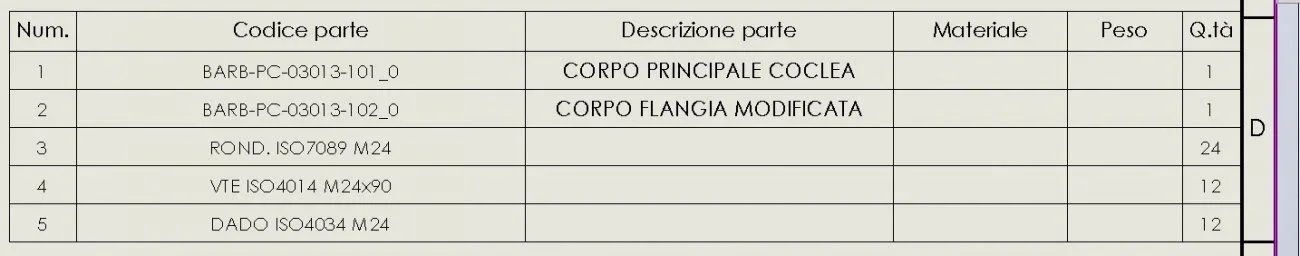

I have a question that I would like to clarify. on a separate material of a board, can I insert links to the properties of the individual parts??? ? that I know, like the material of the single part, weight etc....etc....
the separate materials read only the properties of the individual parts or subaxis if it is set as the first level
Okay, and I remember that. I mean if there is a link (hypertextual type but I don't know which) to make the material appear in the board (photo attached) and the weight of the single part appear. I would like this hypothetical link to take the material of the individual part.

in the distinct you must recall the specific ownership of the part.
if in the part the property that recalls the weight is called weight in the distinct you will have to recall that property. if you have parts with discordant properties you have to make them unique

instead in a set???? In the part I do everything in order, it is in the axieme that I have problems.
the distinct materials read only the properties of any subaxis not of the main axieme.
