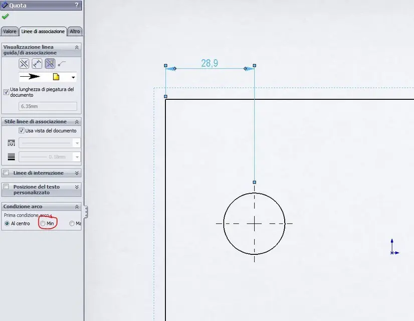

it is not that you can tell me if you can put a quota in the following way:
I have to quote from the edge of the piece to the edge of the hole(tangence) but it always takes me the center of the hole...
you can do so by changing the proportions:1.webp
hold down the tasto shift while quoti and once the quota is released, it remains attached to the point where you clicked.
