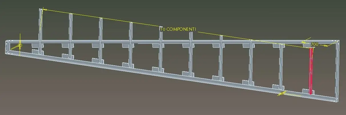

as you can see from the image I have to insert the beams to l in the roe but wanting to make everything easily editable I wanted to make the series and leave the proe the task to modify the various lengths. I had tried to create a relationship based on the angle of the goat and the distance from the longer beam.
without considering that I was hoping to make the series and mirror the whole figure with respect to the long beam so as to create the figure of the roof but at this point it is best to do a unique operation that creates the elements in the two directions (if possible). thanks for the help:finger:
