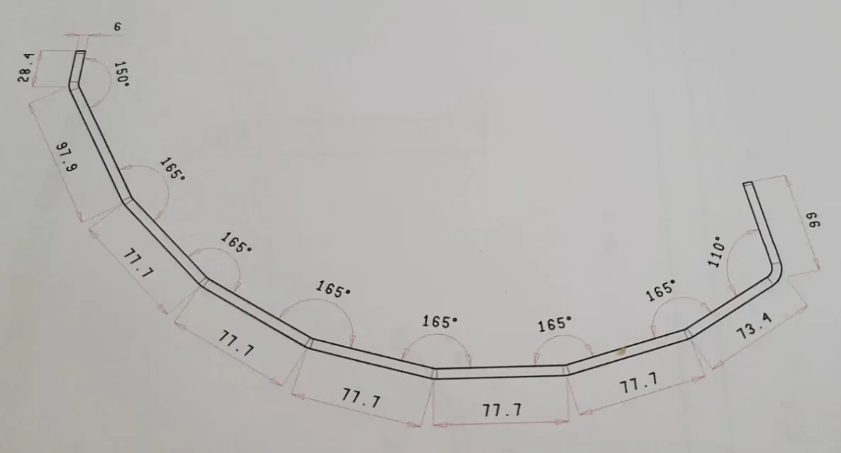

You haven't gone far, though, 640.2. however I solved following the indications of "re_solidworks" that I thank. of fact my need was to draw the sheet and have a theoretical development that obviously varies also sensibly with the value of the factor k. for this my bending machine (almost pointy) asks me to insert the k factor according to the thickness of the sheet to align with the value it uses in the machine.How do you charge a rifle if you don't have ammunition? I did not enter the program that is used, but I gave some basic indications that are also valid with different tools.

the external quotas are fundamental for the calculation of the development, as could be the internal ones, but not recommended.

it will be interesting however to check, how much the development given by solidworks differs from 638,3.
