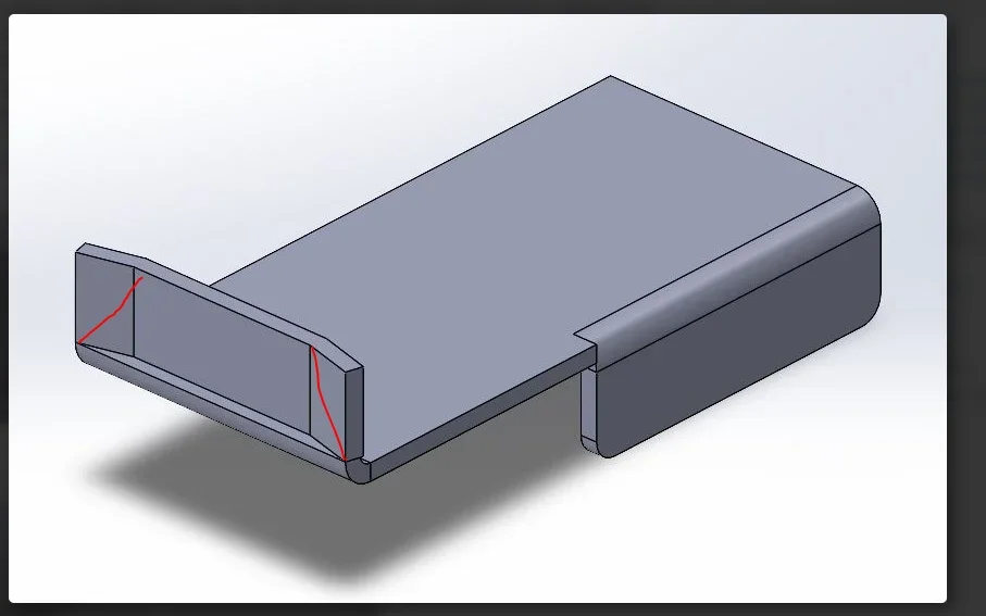

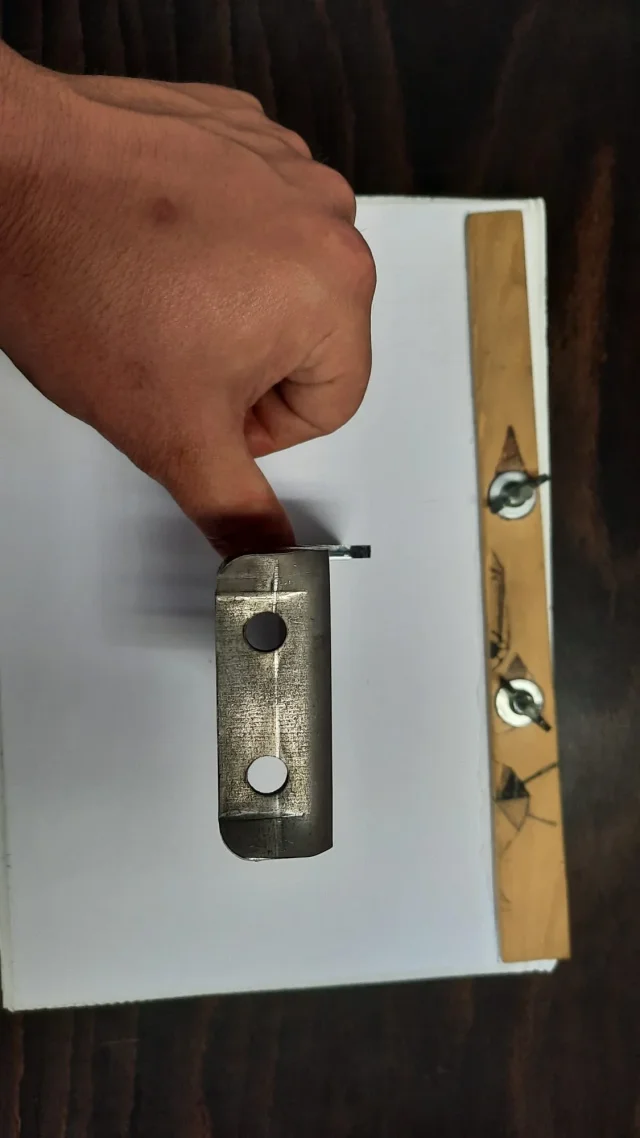

It's been since yesterday that I've been banging my head on the following problem:
I have to realize "the reverse engineering" of a plate that I received and of which I attach photos.
I have to make a "form" as from photo, right near the fold.
I tried to create a training tool on which to work but as soon as I overlap the fold, impossible artifacts are generated.
I thank anyone who has any suggestions to give me.
use solidworks 2021 sp.2

I don't have 2021 I can't open the file but at first sight these two folds as you did are not real.. .
1654508960968.webpthe final result should be more or less so... be folded according to sketch. . .
less than 2020-2021 novelty this sheet is not developable with solidworks. need specific application type logopress.
thanks to @sperx e @re_solidworks for interest.
I also consulted my dealer and suggested that I leave first creating the flange on the edge of the problem by means of a "Loft Folding". the problem is that then I can create a flange on board only of the central part that is not extended to the two lateral wings.
even with a training tool are acceptable results (the screenshot I posted was to illustrate the impossibility of following that road).
not having the need or the possibility of investing on specific applications (such as the suggestion of logopress) I will proceed with the sketch fold, approximation and putting notes on the table for those who will have to realize the piece
