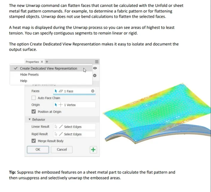

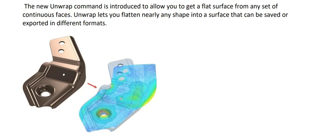

until the 2019 version it was possible to develop only sheets worked with the bending machine or rolling.
the 2020 version should do this:
