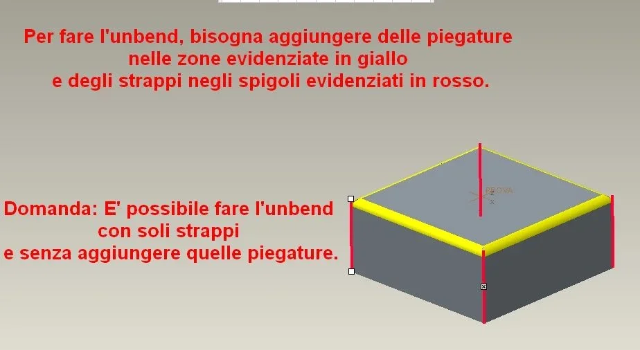

I'm freaking out with a client about developing a sheet.
attached an iges file...it requires tearing edges as from images without adding folds to living edges.View attachment tek.zipThanks for any idea.

the problem is not in converting sheet but in doing the unbend.
see pictures lamiera.webpThank you and good Easter.

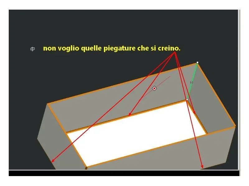

I can't..creating only straps, the feature fails.
I'm gonna make the folds that I don't want.

as I have specified previously, by force bends are created as from image.
I want to make the tears, but it denies those folds, and then I can make the unbend.piegatura.webp
