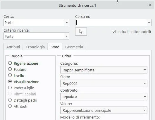

in the office we created a set with many simplified representations.
the "official" representations are a, b, c. but for various feasibility studies other representations were created d, e, f, g, etc.
the problem is that now I would like to clean the axieme and keep only the components of the a, b, c
doing it "by hand" is almost unthinkable or at least extremely expensive. the components were inserted without a sequence or groups in the model tree.
is there a way to isolate/select the components of a simplified representation, for example f, to delete them? I would be fine even if they were highlighted or filtered into the model tree. This would make my life easier to identify them.
Thank you all.
