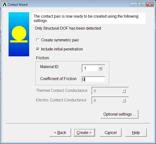

bonded is obviously also in the classic.
in preprocessor environment, start the contact manager (the icon on the top left), select the contact and target surfaces and at a certain point arrive where the friction coefficient is inserted.
you put them 0 (any number is ok) and then click on optional settings.
see attached pictures, where standard text select bonded.
