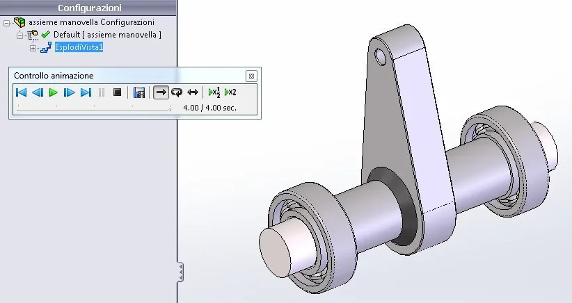

I've got a set that's already bound and I'd like to make a presentation with the assembly sequence... But I just didn't understand how to do it. Could you give me some tips or link example? Thank you.
If you follow the tutorial to do the explosive views you will find everything. Anyway, I'll give you a quick and easy example. it is possible to have mounting instructions via balled explosives or via mounting/mounting film.
I believe that if it speaks of assembly sequence it is obligatory to use a sequence of images, from here a series of multiple views, if then the presentation can be animated then the film is fine.
