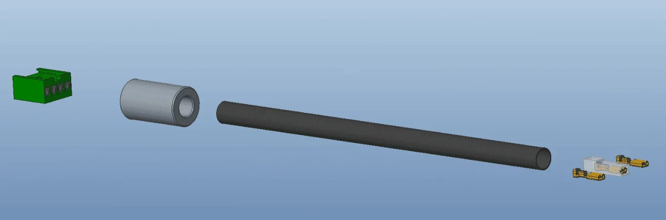

Hi, dani,
I created parts from the 3d and then I did the continuation of the cable with points. Here's the result. I don't think it's the best way but buffer not having the wiring modeling package
if you need to represent the cables to evaluate the encumbrances and their passages, it's more than good.
hi dani I forgot to attach pictures
