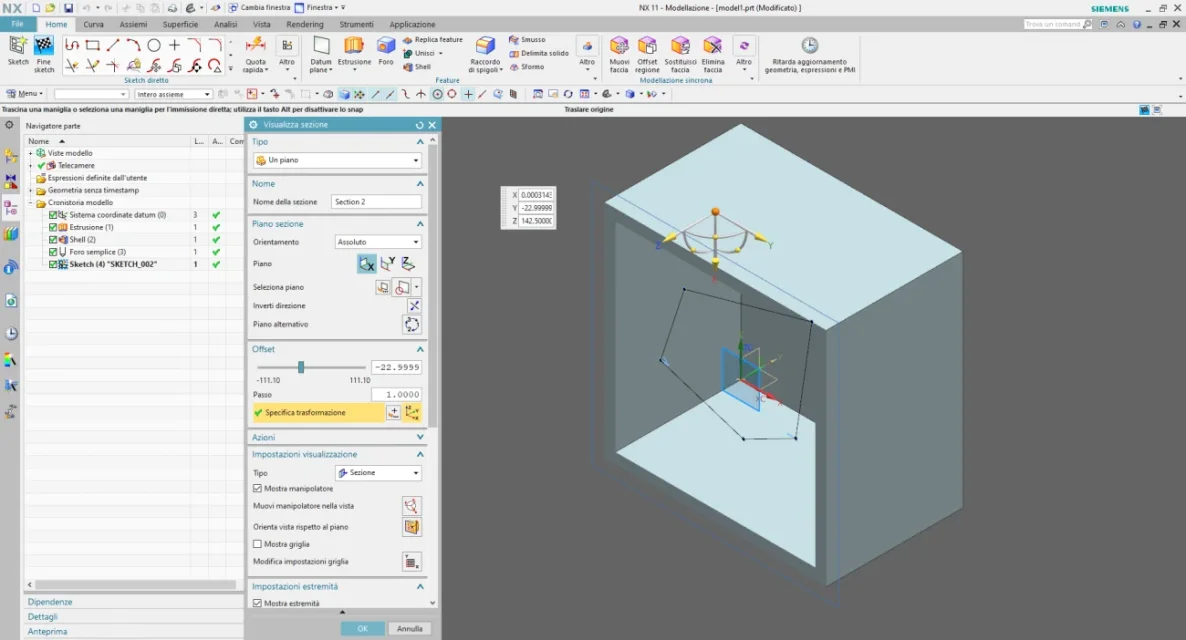

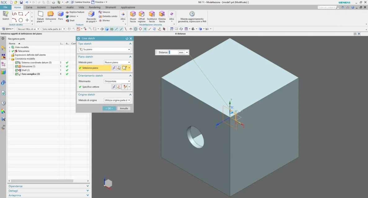

good evening to all, in the version of nx 11 when I do a sketch and then staying inside the same I also do a section, this, if it is placed in a part of the plan above the sketch, hides it and you can not work or see it.
is there a way to make the sketch remain visible independently of the section?
I hope I've been clear, thank you.
in image 1 you can see the plan in which I create my sketch, in image 2 you can see my sketch, now if during the sketch I do a section of the detail in front of the sketch (image 3) you see it, while if the section I do it behind the sketch (image 4) you can no longer see it.
I hope I've been clearer.

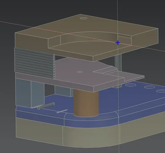

What I tell you is the "section" function (and his sister "slice") you have on the sketch home.
when the selection does a section on the sketch plan.
if you activate the "slice" it makes you a section on the zero depth sketch plan.
I don't understand what you want to do, otherwise
1634646970047.webporiginal
1634646998836.webpactivated section
1634647026999.webpslice type activated section

Now I understand why we didn't understand, I had specified that I use the nx11 version, while you're using a newer one; the commands you have as independent functions, in the 11 are inside the section function. I have not been able to make myself understand what I wanted; I'll try again.
Imagine doing the sketch where you posted the photo, at this point I do a section, we hypothesize the same as you did, only that I do not care about the slice (or slice) but it interests to see all the 3d behind the section. At this point, as you will know, the section can move forward or backwards making less visible the 3d. If now I do a section more or less where the orange cylinder of your photo is located I will see the 3d and even the sketch, and this is good for me, but if I do a section where the holes of that blue plate are found I will see only the 3d section, while the sketch I will not see it anymore. Here, instead I would like the sketch to remain always visible, regardless of the position of the section.
