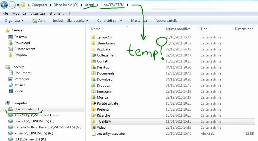

c:\users\you\appdata\local\temp (2gb)c:\windows\tempo (106mb)- can I delete everything that they contain without problems or should I look for and eliminate only swx things?
- I have to worry about closing all programs or deletion first does not cause problems?
Do I have to worry about not erasing today's files or in use or not?
my advice is to erase only the temps in the local, move everything in the basket, restart verify that solidworks and the pc start without problems, and then eliminate them altogether, at least this procedure that I was advised during the course I did. However it should not contain anything important, and in case there is something important in general you report it before or it does not really wipe you out. I in my personal temp in window I do not touch them, as what about solidwork goes everything in the temp. for the rest a cleaning of the temps every now and then it is advisable and before you remember to close solidworks.
there are several programs that make the "cleaning" of the disk, the same button "pulishing disk" in the properties of the disk of windows does it, erasing the temps, the caches and everything else.
some programs are more aggressive, others less (discord cleaning obviously is the least aggressive one).
I sometimes use advanced system care and for now has never erased necessary things. while sometimes it happens that some cleaners of the registry erase some autocad keys that are then to be reinstalled via a special program of autodesk (present in the installation cd, at least for 2004 it was so).
