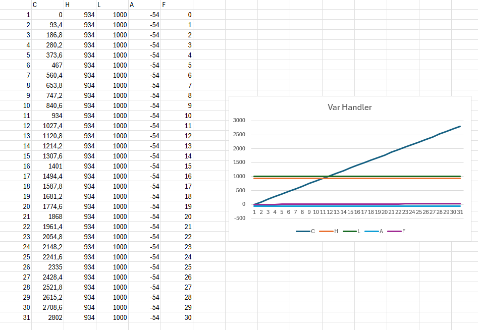

export results in excel after play

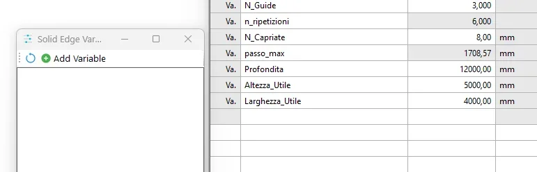

with your sample set it all works perfectly, if I try with my file it gets me the value that amount.
I also know that I can import only variables created from zero by the user and not those renamed but maybe you already know.
however very interesting (y)

Yes, for the moment only the variables created by the user are supported. I decided to limit the combinations to reduce the variants until everything is in place.
Can you tell me the sequence of operations where the value gets high?
p.s.: another limitation, which I have not written, is that the values are varied only for whole
just amount the variable in your application varies the value.
I didn't have time to try with other my asses, maybe today I try.

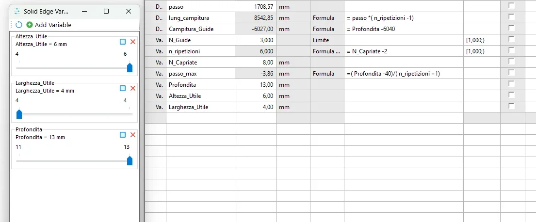

understood the gabola by looking at your variables and actually makes sense.
the imported variable has to have a range otherwise it snaps. I put a range on mine, and now it works.
you can define the range directly from the program by clicking on the values

question (more than one confirmation): does the program not read the paritetic variables, i.e. the variables within an adjustable set? I would like to use it in a total of machine tool, consisting of many adjustable assemblies, inside which there are variables.
Thank you very much in advance.
the program works on the variables of the open file.
Adjustable assemblies read the value to be used by the axieme in which they are otherwise you may not have different positions.
In fact, in the main axieme you will create variables to be assigned to each of the adjustable axiemes and these will be driven by my program.

  • export on excel of results
