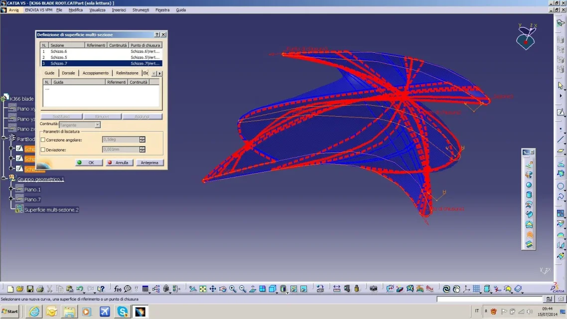

I attach the screens that appear.
Moreover if in your file gate multisection, I am no longer able to reconstitute it as it manifests the same errors.
Is it a problem with how I click profiles?

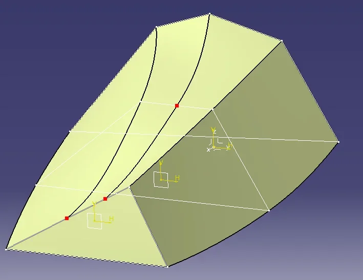

1.webpthe sections must be selected chon a congruous order, but the error you commit is that you do not align the closing points.
by means of the button on the text "point of closure" replace the position of the point in the areas indicated with the green.
I had to change in coupling-relation because with tangency it was equal.

Mar[/QUOTE]loft is equivalent to multi-section.
the various options vary to the surface quality, with ratio, the arches you use for the surface are divided into equal parts and the various sectors are connected to each other (you will notice that your surface is divided into multiple patches).
mult.webp report
multiII.webp Summit
and if you choose the closing points properly you can condition the patches (for example converge them at one point), if you need to ask;)
