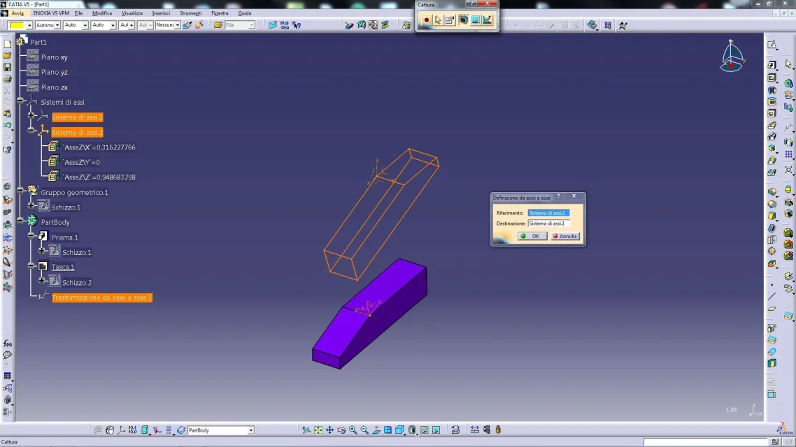

if I wanted to export my component (e.g. in iges) with a terna other than that of origin as I do? I'm sorry, but I thought I solved the problem, but it's not like that, reading on the forum, I found some discussion on the subject, but not clear answers.
If I wanted to export my component with a terna other than that of origin as I do?
as I have already written, you have to move the geometry according to the new terna:
1) create the second terna
2) menu / insert/features of transformation/axis axis (you will see moving geometry from the second to the first)
3) carry in iges (better in step)
because the system exports geometry in neutral format but cannot do so for the construction entities like the axes as they would not be recognized, I believe that the only way is to bring geometry to the point of origin and to guide it using precisely from axis, in this way when the amounts is in place.
otherwise if it confuses you, you can create a fictitious axis using identifiable lines (e.g. axis x long 5, axis y long 10, axis z long 15), carry everything and then inside the software (e.g. cam), perform the translation
Let me know.
