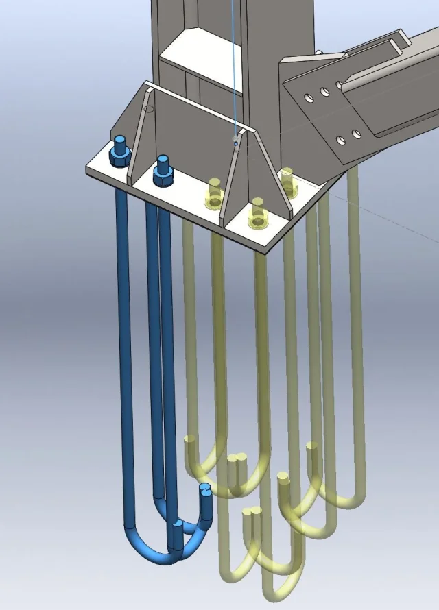

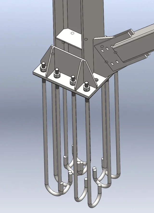

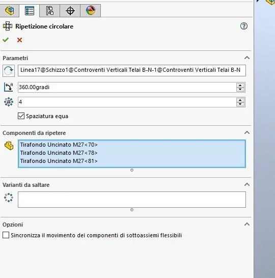

we pay, we update both software that I know and eventually lost time also work. Today I have another beautiful thing that I have never seen before and that I sincerely do not understand, but that however after the last updates of win10 (.... vabbè da Let's pretend nothing!).
I'm doing a circular repetition of those 3 elements you see2.webp3.webpI confirm the function and voilà that appears? !1.webpI ask that I may always have wronged something, but I think that being the elementary function I don't think so, so tell me what might have happened?! I do not know if you happen to yourself strange things of this kind, but this is the fruit of this software house policy, of all indistinctly I believe. It is necessary to interrupt this process that leads us to exhaust ourselves!
I look forward to your considerations about it, because hearing the assistance and making me say that it is probably an installation problem or that with the new version everything works, sincerely. . .
what you see is that there is a shortage of backgrounds but only in a position. is he absent?

of two files that you have attached I noticed that in that working the axis is drawn in the axieme while in the other it is drawn in the part. for scruple try to draw it in the axieme also in the kissed one.
I did the repetition function again, and I don't know how to tell you... I don't think there's a painless way... I mean, it's gonna hurt you. repeated the components correctly; I also only changed the function by eliminating the kicked wallpapers, closed the function then re-edited by adding the wallpapers and ... I don't know how to tell you... I don't think there's a painless way... I mean, it's gonna hurt you. .........
Then I did the test, too. first I did sketch together and edited the series, e-mail result was the same. then I deleted the old series and I remade it et voilà came all correctly!
