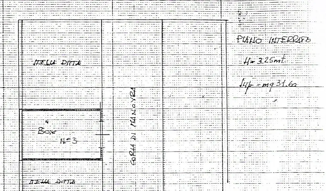

I have a question to ask you I would like to build a loft in the garage, the garage and located with ramp and space under the building as well as other garages.
I wanted to know if there are regulations, permits, etc. to realize it or being private property I can build it quietly
maybe you could give me more info about material etc
allego seedling
greetings

thanks for the answer
but I would like to do something simple without leaning on you have walls maybe with tubular for a 10mq of footless or wooden without requesting any authorization
this and the building regulation of my commune
my garage and about 32mq and height 3.25m
