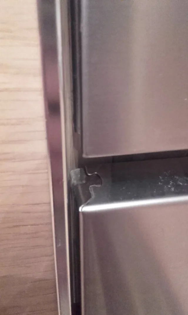

Good morning, I write to ask for your opinion, that is:
in the home oven I have seen that the satin frame that finishes part from the front face has a particular bending or for how the piece is folded it is not necessary to weld the common edge that is commonly created when the sides of a sheet are folded.
According to you there is a function in solidworks that can create this fold or you have to create normal side bends and then work from flat repetition? thanks in antipo.

practically an incarceration.
maybe there was something in 2018, but I don't remember well.
otherwise I don't think it's possible
I confirm... yesterday I had seen the news from 2018 and there is this function that is called "tab and slot" but from what I saw creates only dowels of snapper straight not to tail of swallow in case it looks on youtube.
sent by my bike x4 using tapatalk
already the fact that you create the dowel is a nice step forward (this memory thing that works worries me), maybe you can change some sketch to adapt it to your needs
