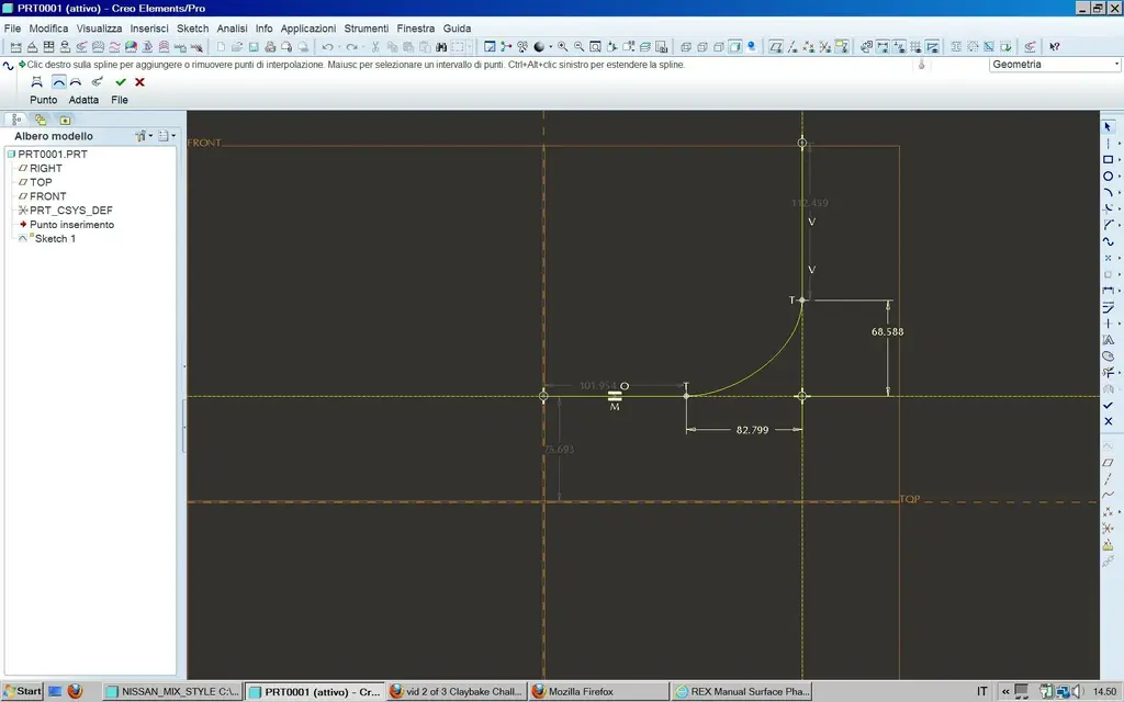

no the odds are not blocked, but you saw the video minute about 3.20, he has everything bound but quietly pugest the points of control instead if I put only one tangency bond already I can no longer click the option; For all
on an English forum I had read about that some versions of pro/e allow it while others do not; to me it seems a minked but remains the fact that I can not unlock that option
You're right.
with the wf3 you can (as in the video) . with the wf5 no! and not with creo!
I tried to see in the options in the config but I found nothing that can rehabilitate that kind of control on two-point spline.
but you could come with a trick.
three-point spline, without tangency, activates the control range and then imposes the tangences of the polygon, then eliminate the intermediate point.
I try to describe it as soon as possible. next time.
Try that.
Before making the connection spline, try to make two tangent segments to the two side splines previously made. segments make them construction.
then the spline for the two extreme points.
change spline.
activate the control range. Okay.
therefore in skecth makes parallel initial tangent segments and the two extreme sides of the control range.
