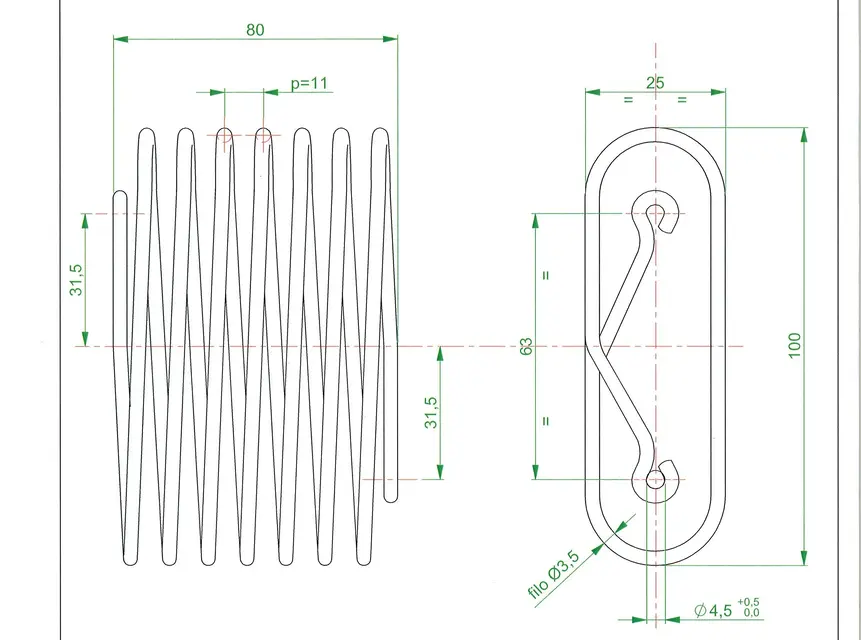

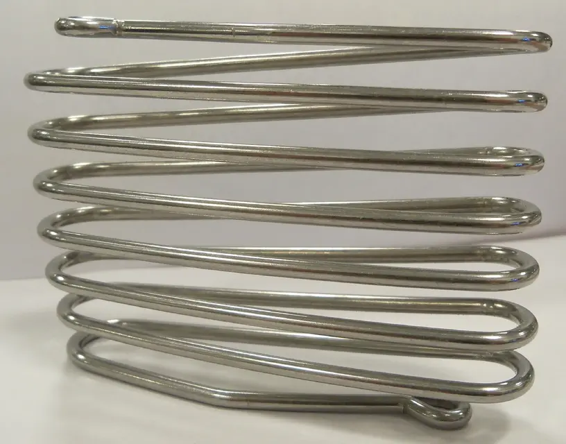

Good morning, I should draw a spring with oval-shaped spire, I tried the helical command but I can't build it.:confused:
I also read another discussion here on the forum but I did not understand how to build it.with s.w. I am not very practical of ect spirals.
allego photo drawing 2d and photo piece realized.
greetings

I believe that with the helical command you will not be able to do it, as, in the sketch, it only works with circular geometries.
I would try with a sweep extrusion.
hi, I solved by making a surface with the shape of the spiral; you make a construction and then project the lines on the surface and then sweep. inspiration came looking at the photo of another post...healthy
(maybe you put the link to the image that inspired you, so it can also serve others).
I would do like this:
extrusion of a surface from the oval shape of your spring seen in plant.
creation around the surface and for all its height of a circular propeller with the parameters of your spring
propeller projection on surface
spring creation with a sweep using the projection as a path.
