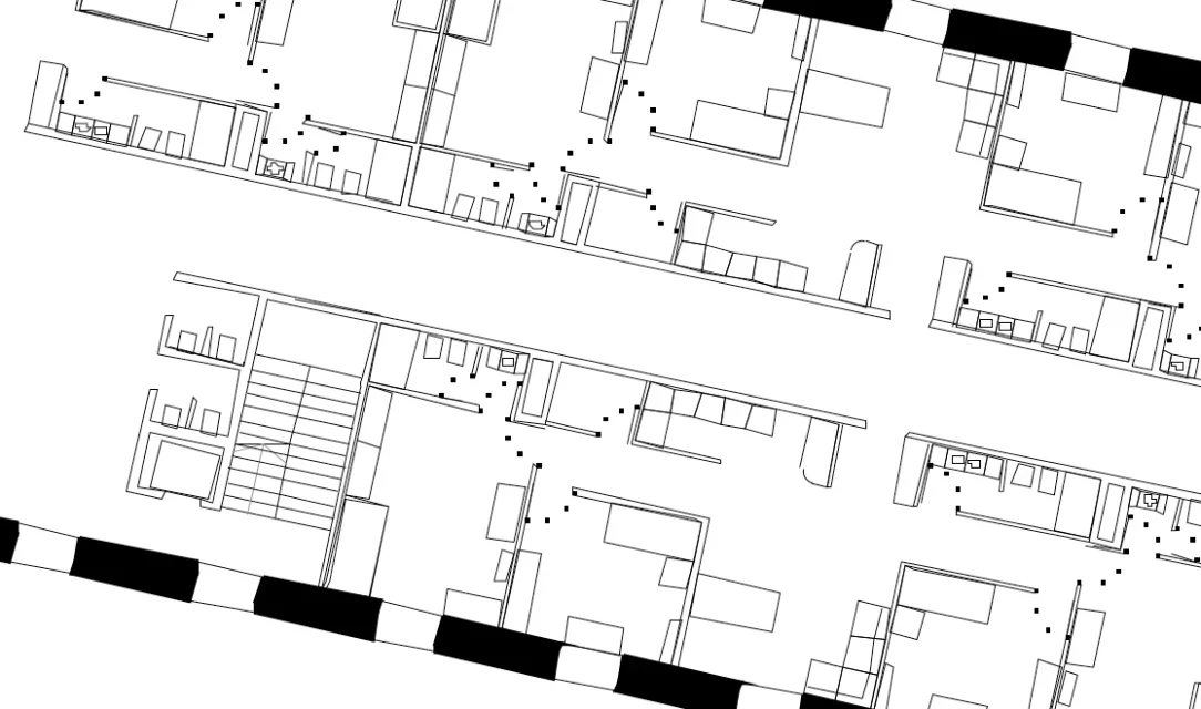

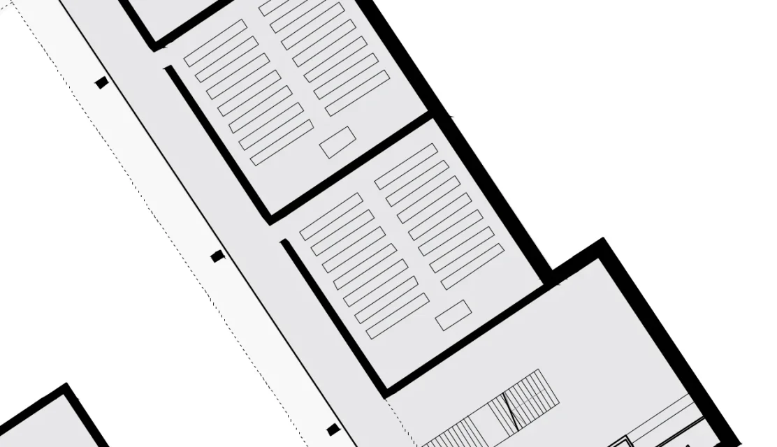

if you mold a pdf the lines contained in the file are good, but the linked lines (xref) are segmented and deformed. for the rest I can control colors and line thicknesses of the xref, but already in print preview I deform the lines of the xref.
Any advice?
I attach two parts of the same pdf, one corresponds to the lines in the design and the other those of the xref.
autocad 2015. mac
Schermata 2016-11-18 alle 14.41.05.webpSchermata 2016-11-18 alle 14.41.40.webp

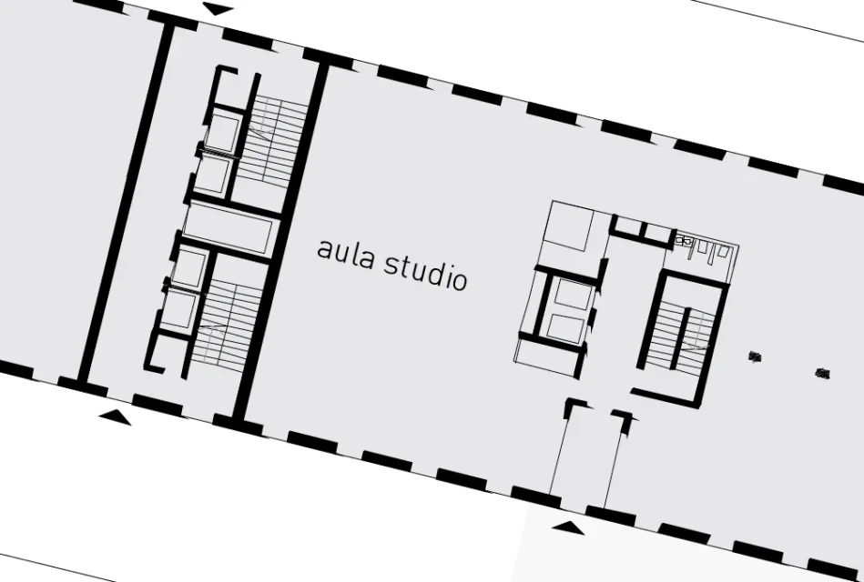

Those huge points should be point lines with 0mm thicknesses, among other things, but what worries me most are all those forms, which should be rectangles.
try downloading a 2017 trial and see if the problem is reproposed. on win never had similar problems
