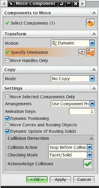

is it possible to set stop before collision so that the collision occurs at zero and not at a certain distance?
If yes, could you put an image of the set?
I honestly looked in the help, but it talks about a set step that I can't find anywhere.
I use nx7 in English.
in "move component" set the parameter
collision action at "stop before collision"
and
checking mode to "facet/solid"
If you're in dynamic, you're going very close. . .
If you want to go to zero use by constraints
and

I did all the evidence of the case and read the help and came to the conclusion that you can not get to zero.
the movement is not continuous.
everything is done incrementally.
when collision detection is active and the object is moving, for each collision increase, a test is performed and if the objects are in collision state, the system returns to the previous position where there was no interference.
collision detection is, say 'preventive.
even if the step is small and the parts move slowly, there will always be some space between the objects when they are stopped following a collision.

depends on your ultimate goal of getting to zero.
with the stop before collision, with the appropriate settings, to me, in a simple case, stopped at 0.06 mm (so for me it is zero... is called stop before collision on purpose).
If you have to get there at zero, then there is no scandal to use the "move by constraint" or, extreme ratio, but it seems to me to shoot with a butterfly cannon, with the assembly sequences.
What do you need to get to zero crack?
