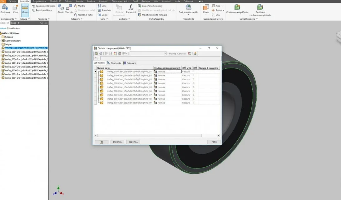

Hello everyone,
I want to change the property of the parts in a set and put purchased are that I can't do it... why? ? ?
Thank you 1000 to those who will help me.

Are they extracted from the vault? or alternatively, am I alone reading?
are files contained in a nominated library folder (which is protected and I don't know how to protect it) a network hdd..the vault didn't...I found that if I cover files in an external folder (e.g. in the desktop) and don't renounce them then it makes me change the fields; if instead I renounce the file together no longer makes me change the property in question...:unsure:
Can you tell me how to protect or protect the files contained in this library folder?

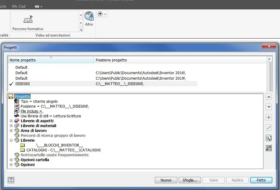

library folders are defined in the project file:_foto__687.webp
you can't edit a library file from within a project that uses that part.
creates a "free" project (resident in the library root folder) with which to edit individual files.
