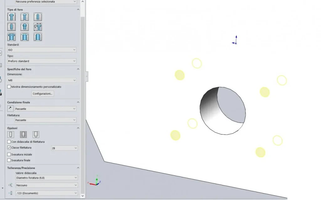

threads do not, but I think it is a video card problem because you see attached file in the solid do not appear but in the table yes.

it was enough to choose central icon under options and check thread caption
