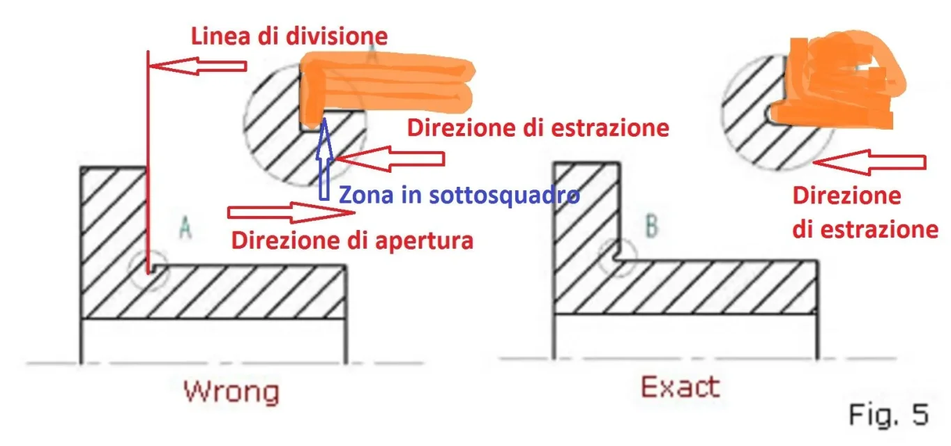

a subframe is when the shape of the detail to be printed is such that it prevents the division and extraction from the cavity without damaging the particular itself
this is meant to usView attachment 47393
in case wrong seen the division line if I go to "open" the detail would split in two (and we are); in the case exact instead? the division line can't be the same otherwise I can't extract it the same or am I wrong?
same division line, same opening direction.
wrong, the piece does not pull out, exact the piece is extracted.
let's see if it's clearSottosquadro.webpImagine that the orange part is the steel of the mold.
in the left image, translating the piece in the direction of extraction you have a "dent" that does not allow to extract if not ruining the piece.
in the right image the problem is not there.
let's see if it's clearView attachment 47396Imagine that the orange part is the steel of the mold.
