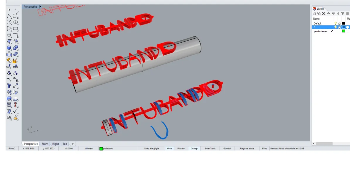

Hi, I have a problem.
to create a 3d writing I cut the extrusion of the letters with a tube, and this left the letters with an open face.
Immagine 2.webpGiven the particular shape of the letters and the cut, I am having difficulty closing some faces.
how can I create a surface starting from a series of consecutive non-planar curves? like this:
If instead of cutting with the tube do a boolean subtraction of the solid you should get a good result.
always that the curves of the writing have been done well and have generated good surfaces.
When you say Boolean Sottration, do you always mean with a pipe shape?
However I tried, but with some letters ( u and b) the Boolean subtraction does not work. What to do in that case?
Yes, with the tube or even with a surface.
If the curves with which you generate letters are not done well, there may be small spaces between the surfaces or things like that.
How did you curve?
Actually, I didn't, and I found out that this was the problem.
reviewing some letters, I found small errors as you said.
I solved by redesigning the letters in question, extruding them and making the Boolean subtraction, thus obtaining the written cut and closed.
Thanks for the help, I was getting crazy.
