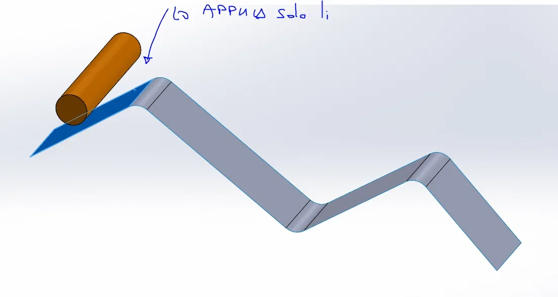

I ask you one thing, if I extrude a spline as a surface and then bind it over a cylinder with a tangent bond, it all works because the cylinder follows the surface.Instead if I extrude a surface starting from a sketch consisting of curves and lines, the tangent bond takes it only to the straight or curved section of the surface.
Can someone tell me if there's a way to get tangence to the whole surface? ? ? ?1582103283047.webpI have already tried to make it a path and also using composite curve, but nothing to do

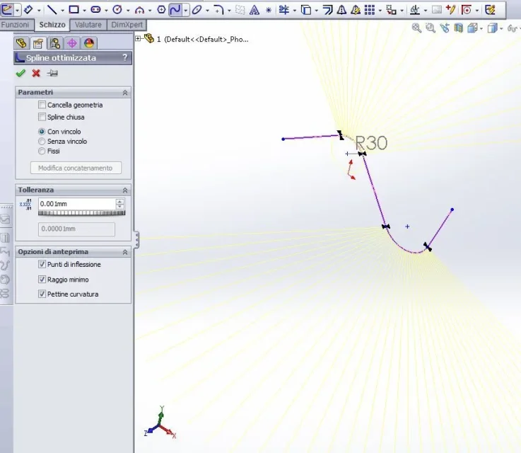

to make sure that the cylinder maintains tangency the surface must be continuous then created from a spline. you must use the command "optimize spline" by removing the flag from "closed spline". after using the resulting sketch to extrude the surface. see image and attachment. My version is 2013 so you can have avant-garde people:) have slightly different commands and options.spline ottimizzata.webp
