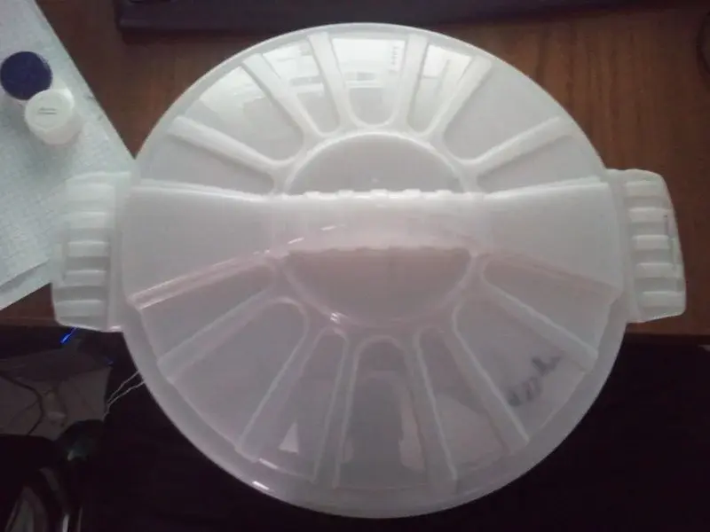

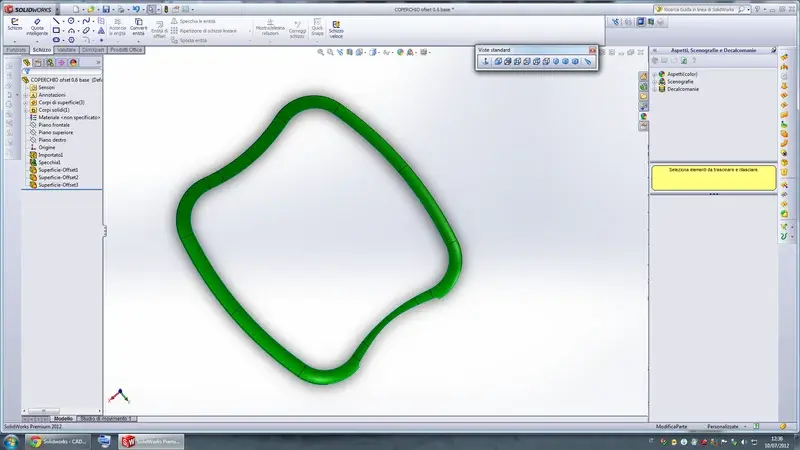

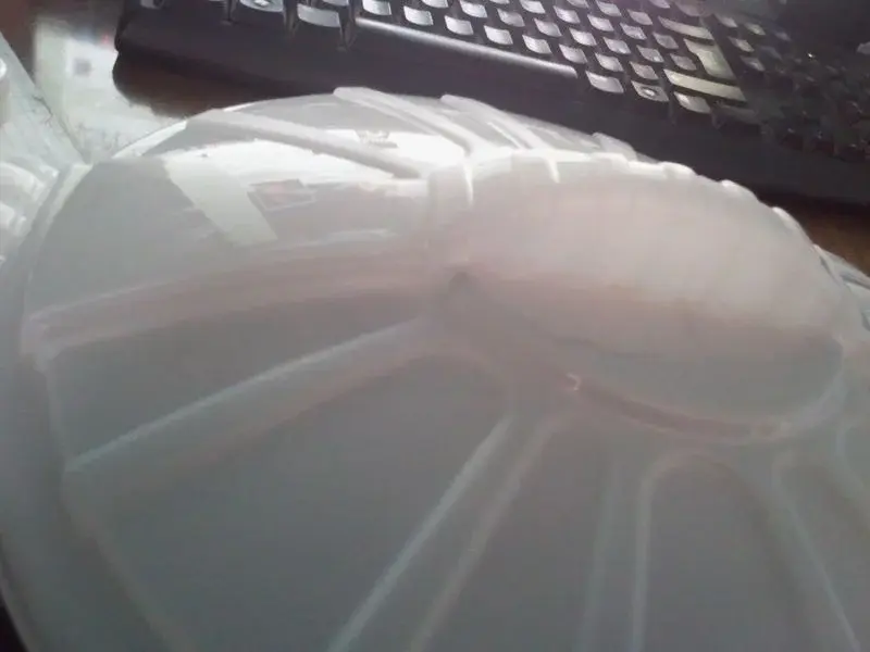

This is my contour where I must go to insert the surface with the processing of the bucket that I will put later. . .
I have this cover, especially I have to bring back the same fantasy by filling my profile. ..the same fantasy on the surface to "cupola". .practically it must be equal to that of the bin below, but with different external profile. .also central socket and handle... .
20120710122033
Now my question is this... I carry out the cover of empty space in my profile with a surface loft... how do I make the reliefs, how do I make the central socket and the external socket with relative reliefs? ? ? ?

Since you have to change completely (from round to picture) I would say that it has a lot of freedom of interpretation. I started doing it directly in solid, you have the basic size and the lime you can build a big patch that gives you the shape of the dome then for the ribs imposed on a sketch on a plane and create a solid extruded offset. in the end for the handles take caliber and ruler and the cups as faithfully as possible.
Of course, explaining it in words is a little hard... I'd say it's easier to work on it and make attempts, then during the job you're asking...

I've been away for an important examination and today I'm starting again... I wanted to know how to make a sketch on a curved surface. ..practically I wanted to extrude the ribs on the base "cupola" of the circular lid,as it is raised in the center...this I can not do...
