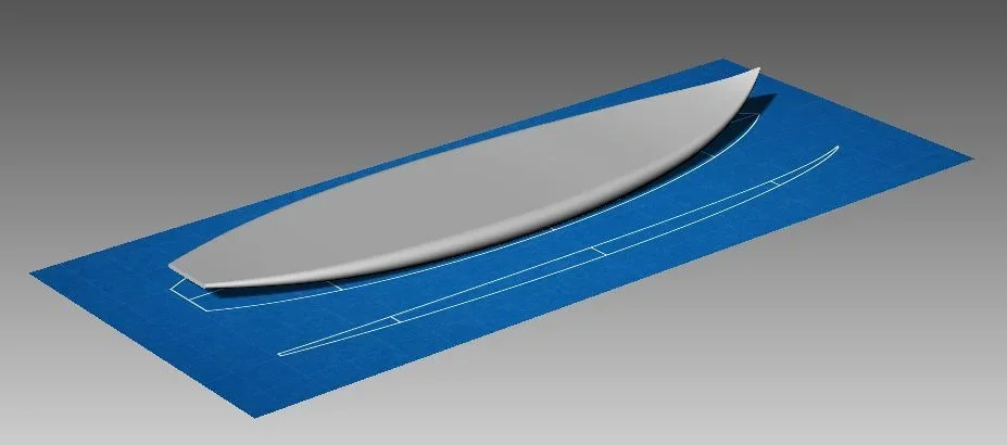

You're off the road.
with the front section extrude a surface, project us the top view and with those you create a network.
above all you can do everything with one surface.

I would have created curves in place, getting them from a blue print or a photo.
the surfaces above and below create with an extrusion of the side profile curves of the table.
then cut the two surfaces with curves that identify the edges (a little indented )
then combine the two surfaces with blend surfaces.
attached an example file
