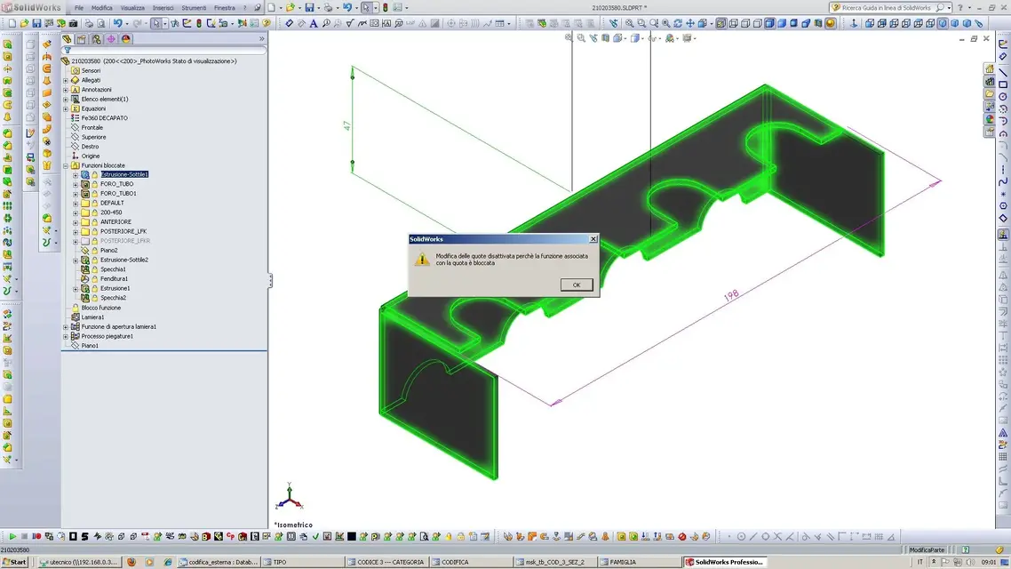

good morning to all, use occasionally solidworks so they are not fully aware of the novelties or the added commands.
I would like to know if the command that allows to block the modification of the functions obtained via macro, as from attached image.
2012 has inserted the possibility to block the regeneration of the functions upstream of the frozen one.
in fact in 2012 they implemented with the command and removed the implementation via macro what in 2011 was possible to do only via macro.
