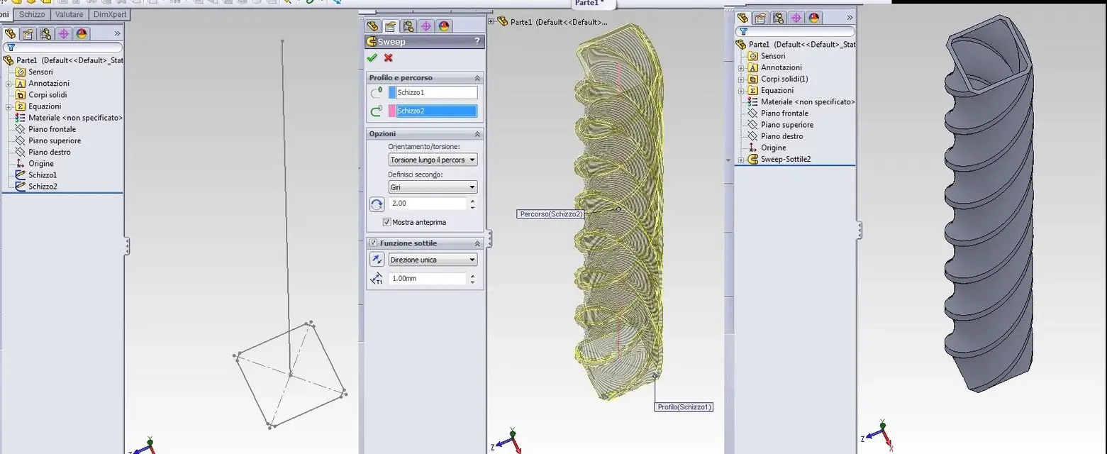

hello to all, I should model the bar I attach as photo, in practice a double helix.I tried in various ways but nothing. I have to start from 14 square tube and then dig it in the middle.I ask if please you can attach me a part to hold as an example. greetings

sweep the profile along the path that corresponds to the axis of the twisted frame tube, then in the options of the function set as from attached image.

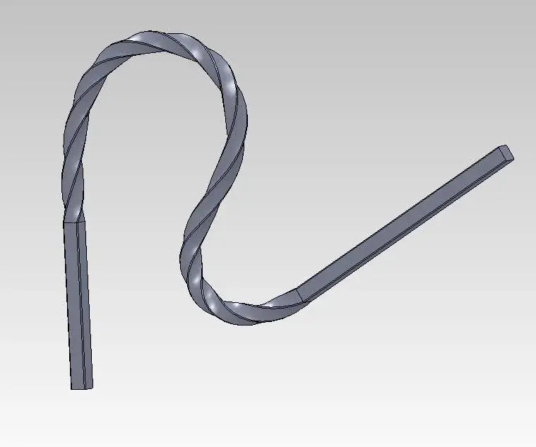

that of the photo seems a twist of an inferriate, and you can get it (as in reality ) using the flettere function with popped the flag on torsione.

exactly torque inferriate. I also try using "flettere".
Thanks marcof for the straight, I did first propeller and then sweep but it didn't work! Thank you for listening.

apart from the issue of performance (using the fletre funzine employs at least 4-5 votes more to regenerate) than perhaps in your case could be influential having few features on the same part, it must be said that the sweep is more versatile because it allows you to have the twist even on variously curved traits. with the tools of twist and bending you become old.. .

"x marcof": thanks to the straights I tried both sweep and flet, rightly the sweep function is better.
