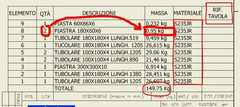

I am now approaching inventor (from self-taught), and I need to ask you a question:
I have created a custom table in parts list and every time I have to make the red-marked changes to the attached file. So I wanted to know if:
-when a set is formed by several identical parts it is possible to have the sum of the mass instead of doing it by hand;
-I would like to set as material instead of generic steel wording s235jr (or other according to the project)
-I wanted to know if you can get the total weight of the axieme
-I wanted to know if it is possible to put automatic reference to the table of the various components of the axieme, without that I have to put it by hand I
for the material you have to create one with name, physical and mechanical characteristics and appearance you want.
When you create the model you will set that material, the table for that field must "put" to the i-properties of the model.
for the table reference you can create a custom i-properties in the model, compile it with the table ref. and point the table to the i-properties.
